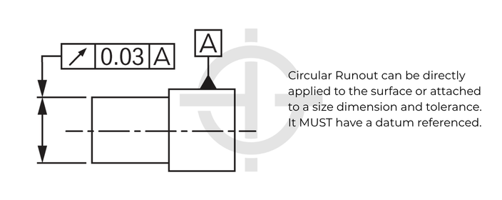

The circular runout symbol is used to control the radial deviations of any given cross-sectional elements of a circular feature. The radial deviations are taken with respect to an axis of rotation established by the referenced datum feature.
Circular Runout Symbol and Callout
Functionally speaking, runout is controlling how much one feature can vary with respect to another feature (identified as a datum) when the part is rotated 360° around the datum axis. It is essentially a control of a circular feature and how much variation its surface can have with respect to the rotational axis. Runout can be called out on any feature that has circular cross sections that are centered about an axis, meaning it can be applied to conical and cylindrical features as well as curved surfaces. It is essentially how much “wobble” occurs in any given cross section of that feature as it rotates around an axis.

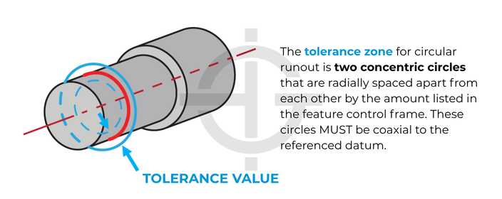

Circular Runout Tolerance Zone
The tolerance zone is two concentric circles, one inner and one outer, that are coaxial to the datum axis. All of the cross-sectional surface elements must fall within the zone. The tolerance zone lies on a plane that is perpendicular to the datum axis. The value of the feature control frame for the circular runout tolerance is the radial distance between the two concentric circles that establish the tolerance zone. Another way to view circular runout is the difference between the smallest and largest radial distances any surface elements have with respect to the datum axis.

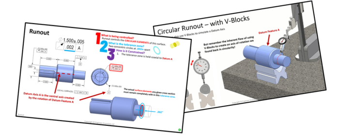

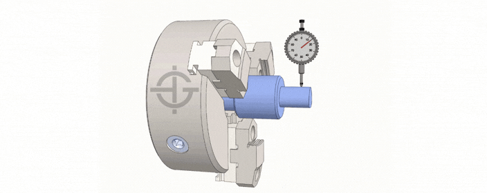

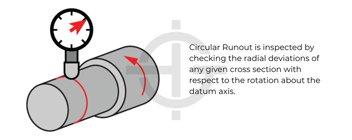

How to Inspect Circular Runout
Runout is measured by using a simple indicator that is placed on the surface of the feature. For drop indicators it’s important to ensure the indicator is normal to the surface and perpendicular to the axis of rotation. The datum axis is created by engaging all surface elements of the datum feature and rotating about this datum feature. The axis of rotation creates the datum axis. The axis of rotation can be created by using V-Blocks, a collet or chucks on a lathe or even bench centers. The part is then rotated around this axis, and the variation is measured using the height gage held perpendicular to the part surface. If the gage does not vary by more than the runout tolerance, the part is in spec. Remember, multiple cross sections must be checked since the control applies to the entire surface.
We cover the intricacies of circular runout, how it’s interpreted, how its inspected and the miscellaneous things you should know about this symbol in our GD&T Fundamentals Course as well as our GD&T Inspection Course. These courses show you everything you need to know about circular runout and then some!

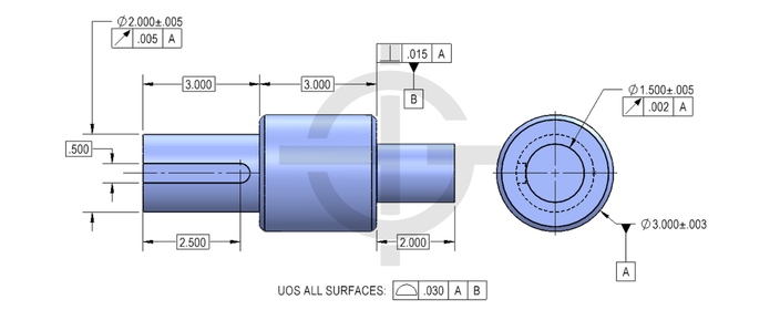

Example:
A shaft that is rotated at very high speeds is prone to oscillations if the right edge of the shaft is too far offset from the center cylinder. To control how much wobble this part will have, runout is used to ensure that the smaller diameter surface is controlled relative to datum feature A.
To control this without Geometric Dimensioning and Tolerancing would be nearly impossible. The small amount of variation in the shaft, straightness of the shaft, and roundness of the individual cross sections would be unrealistic to control. With runout, you have your final rotational condition that you want controlled without needing to specify unnecessary tight control on the entire part.
By constraining with runout as shown on the drawing, you are ensuring that when the shaft is rotating around datum feature A, the surface being controlled will not vary in surface deviations more than 2 thousands of an inch. This will ensure that only a limited vibration is made and that both parts will wear evenly. To ensure this condition is met, you must measure the parts with a gage.
Note: Gage cannot deviate more than two thousandths. This runout must be checked on any cross-section along the referenced surface. You must gage each cross-section separately though (Gaging the entire cylinder in one recorded deviation at once would be total runout).

I think there is a mistake, in the Example the tolerance is 0.2 and the image below said that the gauge can not vary more than 30 microns.
Maybe you are taking the tolerance from the first image.
Yes that is correct – sorry for the confusion – the reference is for the previous drawing.

Runout can be measured using a chuck or collet and a dial gage, pretty straightforward. Measuring concentricity isn’t so easy. If you don’t have a CMM you need some specialty equipment that goes beyond our guidance here. Plenty of information out there on Youtube and google.
